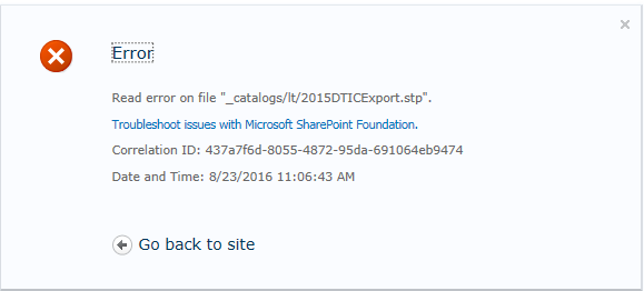

I tried to recently save a list as a template with the content (due to a user who came in and told me they needed lists copied from one site to another on the same SharePoint farm) and received the error below:
I saw posts as I searched Google regarding “List View Lookup Threshold” setting change to be increased and was not too comfortable changing that globally as I am relatively new to SharePoint, having been thrust into the role rather suddenly…
