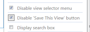

On the actual form library page, I have the My Documents view set as the default view. I’ve disabled the save this view and view selector menu in the Miscellaneous section of the Edit Web Part section.

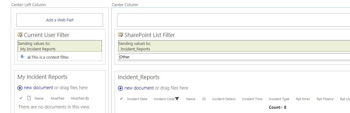

However, I began to wonder if it would be better to create a Web part page to show these views. So on the first page add 4 web parts. the first web part is the form library with My Documents view using the current user filter (2nd web part) to display forms only to the logged in user. I then added a 3rd web part (the All Documents view of the forms library) and connected it to a SharePoint List Filter web part. This filter uses the external list containing the Incidents codes and the person responsible for each code. The filter user the Incident code field from the list (the user can select it right now), and the library is then filtered to only show forms of that Incident Code.
What I’m wondering is how to set the audience on the 3rd/4th web part? If the incident code is Employee Accident for instance, only the worker’s comp rep from HR and the VP for Admin Services should see these forms. I can create SharePoint groups for each incident code which could be used for Audience targeting.
Would it be better to create a separate web part page for each group? or is there a way to conditionally target the result based on the Incident Code selected? (it would need to be OOTB or maybe using JS link as I am not a developer and don’t have access to one).
