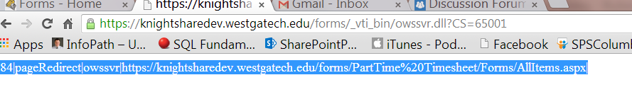

In our development environment, we keep seeing an odd error when we try to modify an library view or delete an item from a list or library.
What makes it even stranger is that if I go back in the browser navigation and then refresh the page, the deletion or modification has been done.
Has anyone seen this before? and if so, how do we correct it?
