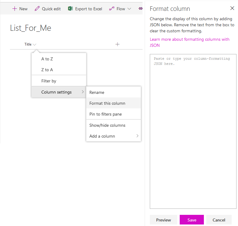

The JSON Code mentioned above “style”: {
“width”: “100%”,will only change the width of the Column Style but not the width of the Column in the List View.

I haven’t tried it but it seems you can use ‘column-width’ JSON to change the width.
https://docs.microsoft.com/en-us/sharepoint/dev/declarative-customization/column-formatting
i tried below code and it work for me 🙂
  “$schema”: “https://developer.microsoft.com/json-schemas/sp/column-formatting.schema.json”,
  “elmType”: “div”,
  “txtContent”: “@currentField”,
  “style”: {
    “width”: “100%”,
    “white-space”: “nowrap”
