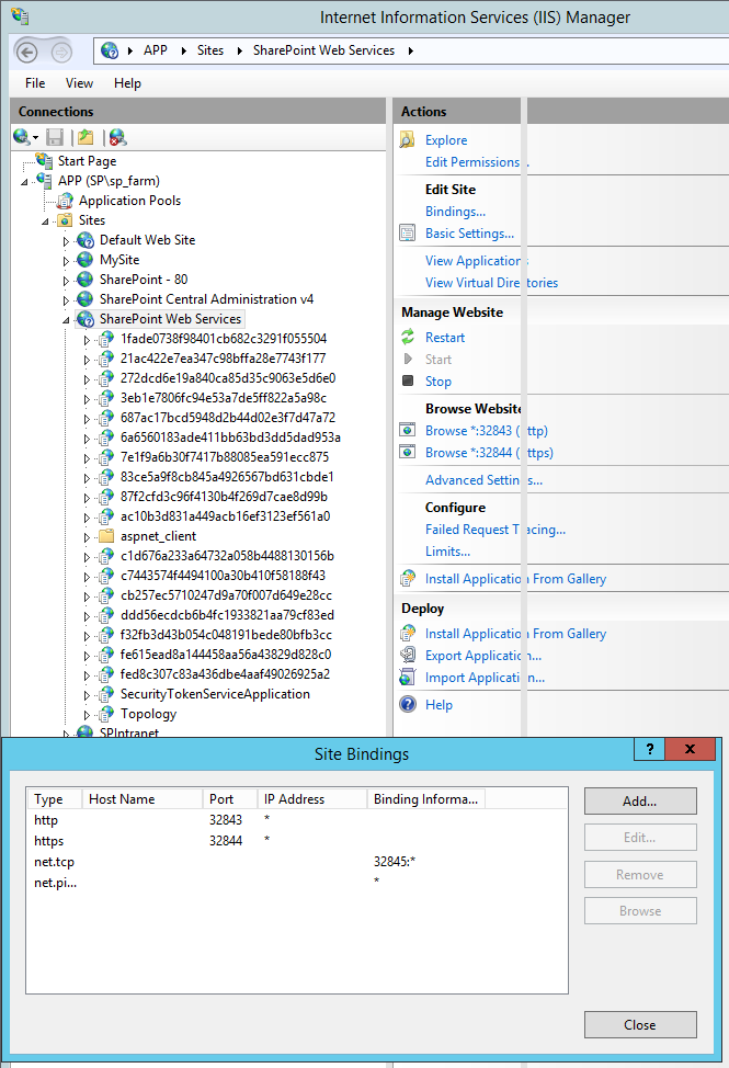

I went to IIS Manager and i wanted to verify my SharePoint Web services status, so i wanted to browse to the `http://localhost:32843/Topology/topology.svc` and i got the http 503 error service unavailable… According to this thread  http://sharepoint.stackexchange.com/questions/101550/sharepoint-web-services-web-site-error-service-unavailable-http-error-503-the-s
Can anyone suggest me how can i solve this probelm please ?or even some suggestions?
My appManagement is set up and here is my IIS site with its bindings :
