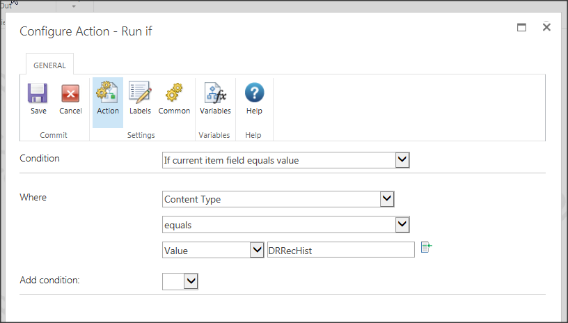

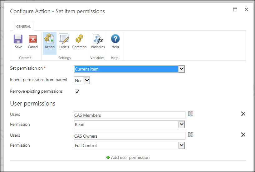

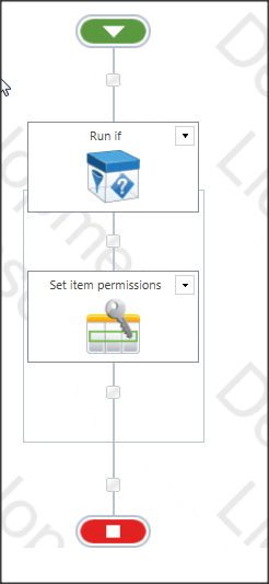

We are avoiding Event Receivers in favor of something easier to install. The way that we handled this problem was to use a Nintex Workflow for that Content Type.Â
The workflow was written to handle a new item or an item modification.
Once the item is set to that content type, regular members can no longer edit the record.  Until I “anded” in the additional condition to allow owners Full Control, I found myself unable to change the permissions on the item.
