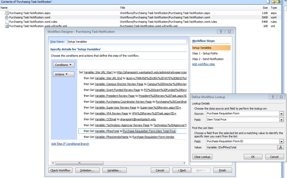

Now I’m back at it with the 2013 upgrade underway, but needing to make some updates to an existing 2007 workflow in the meantime.
Here’s the scenario:
We process our Purchase Requisitions through an InfoPath form with an SPD 2007 workflow (actually 4 of them).
The task notification workflow sends custom emails to the approver at each of the various stages and contains links to the form and to the workflow task. Â I’m trying to figure out how to pass two pieces of information to the approvers from the form. Â When I try just configuring a lookup, I end up with a circular argument.
Anybody here with some SPD2007 skills who has a moment to try to help me figure this out? Â We won’t have the SP2013 site up and running by the time Purchasing reopens on the 22nd, so I need to find a workaround for the moment.
Thanks for you.
The fields show up and and are usable in the workflow (step 2 Send Notification where the emails are actually sent)… they just have no data. Â Which to me indicates that the Find the List Item settings are incorrect. Â There’s probably some simple little something I’m overlooking, but at this point, I don’t know what it is.
