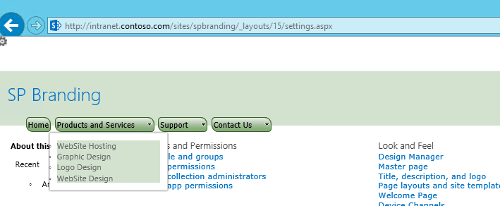

I’m excited about this script. Currently I have it working for 2 levels of simple links. Actually no links are in this version but can easily be add to the fourth element of the table. I have been able to create a submenu but not a sub-sub-menu. I believe it has to do with the way I access terms in the termset. I’m only about to get to the top terms. Help–I know you gurus can figure this out.  Once I get the table working–I want to take the table out and use a csv parameter.

Thanks. All you should have to do is change the URL about line 8. It should match the full path for the SiteCollection you are running it from.
If you have any big PowerShell Errors. Set the Nav to Structural. Then go into Metadata Navigation and delete the TermSet.
It should run smooth from there. Then just go into Navigation afterward and set the Global back to Metadata Navigation and select (don’t create) the termset.
Stefan Bauer thinks I need to update my system with the August CU. He’s going to try it on his machine tonight.
Two levels should show up anyway.
