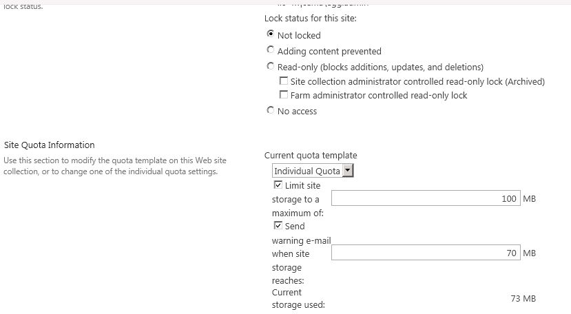

Well, I searched through discussions but didn’t find a similar question from other folks.
We’re on SharePoint 2013. I can’t presently wrap my head around templates, etc. so am starting by testing with individual quota settings on a test site collection. According to the information presented on the screen capture, the site collection administrators should receive an email warning now that the current storage used has (73 MB) exceeded the amount set for warnings (70 MB). I haven’t seen any warning messages.
What did I miss?
Thanks in advance,
Theresa

Hi Theresa,
There is a timer job that is responsible for sending these e-mails. By default, it runs weekly. If you want to modify this, change the “Disk quota warning” timer job to run daily.
If you have any problems doing this, let me know.
Regards, Nico
FWIW: the warning email was received on Sunday. This is likely due to a service / scheduling thing.
T
