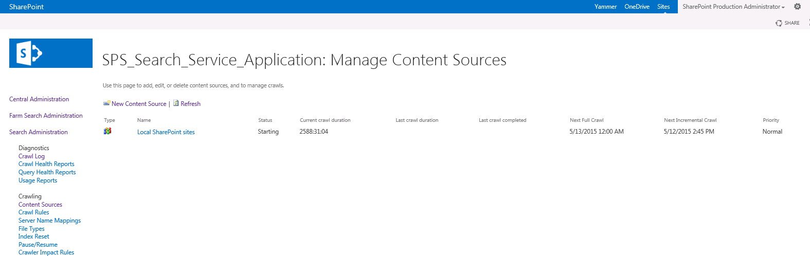

also we have configured the Search settings as well. Please help me to get it done.Help appreciate.

Yes search is working fine only when user logged in(authenticated), and while searching with anonymously did not get any result i did check log into logs files with the correlation ID – 00000000-0000-0000-0000-000000000000,not found any logs.

So you are saying that the crawls are working correctly, and search works fine when authenticated? When you hunt down your correlation ID, are you finding anything? As with most things SharePoint, the solution is probably permissions-based.
