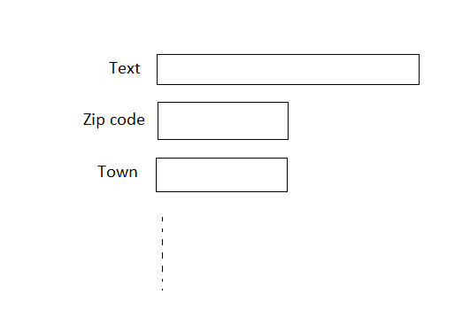

The scetch is below:
So this is how the web-part looks like.Â
- The text field is a regulra search field
- Zip code is a managed property
- Town is a managed property
- And there are some more managed properties
