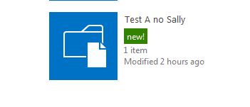

Oddly, if users click on “all site content”, they are able to see all document libraries listed. They can see names, tiles for other libraries, total number of items and modified date indicated beside each library tile. This is not good. The client does not want users to see a list of other users’ libraries.

I performed a test on a test SharePoint 2013 site collection, deactivated “Limited-access user permission lockdown mode”. Created a new document library and separated permissions so that a test user had no access.
That site collection features change still allowed the user to see the library’s existence in site contents AND view the document library but with no contents showing at least. Not good.

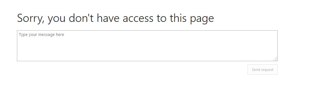

I would rather that the user with no permissions encounters the “you do not have access..” as is the current status.
