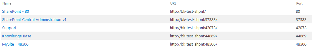

I have this issue occuring where we have 4 web applications for our SP deployment:
The problem is that the ‘Support’ site does not sign the user in automatically like all the others do. It isn’t asking for username/password, one can click on the ‘sign in’ button, then get this error thrown on a blank page:

OK, well I cant say I “fixed” the problem, but have found a good solution! I followed the steps here to extend the application to another IIS application and using different port. Now everything works fine:
