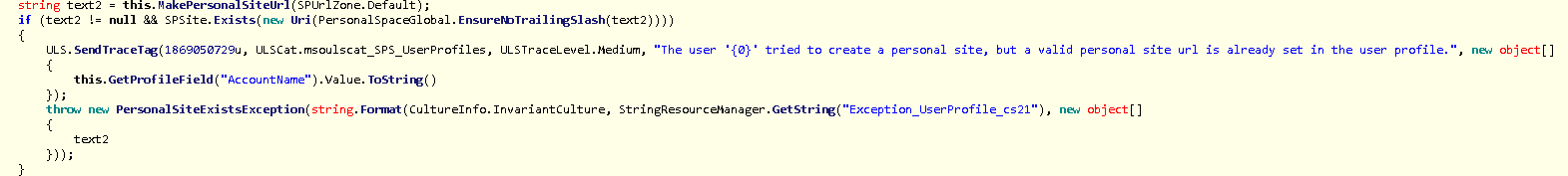

Just had a quick look in ILSpy on the method that creates the site (see below)…
My hunch is that the SPSite method is returning True, when it should be false. Also a bit strange that the the method to get the user personal site isn’t emptied out ..
These guys report a false positive on SPSite.Exists
this.MakePersonalSiteUrl(this.UserProfileManager.UserProfileApplicationProxy.GetMySitePortalUrl(urlZone, this.UserProfileManager.PartitionID), text);
Here’s the snippet of code that attempts to create the MySite.
How are you deleting the MySite ?
